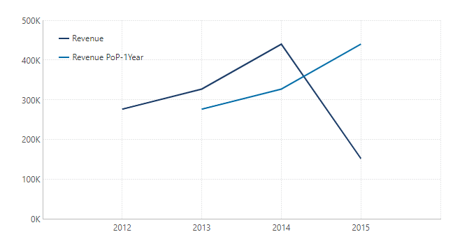

Take a look at this example:
In this chart it wouldn’t be possible to resolve the years as each data point on the chart would be a different year.
Using this sample data, the legend would have to say something like this for each data point to be accurate:
2012 vs nothing
2013 vs 2012
2014 vs 2013
2015 vs 2014
Now, if i were to drill down into 2014 then it might make sense to change the legend to Revenue 2014 vs Revenue 2013. But then would everyone want this? I don’t know… It might be a bit odd for the legend to change behaviour as it drills down. Consistency is an important consideration.
