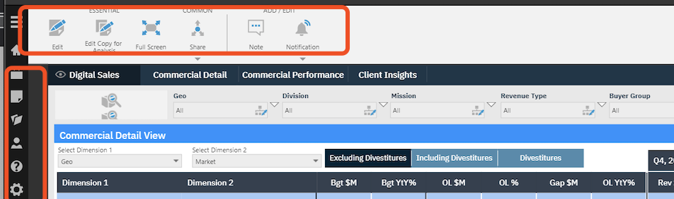

I followed the script example from this article “https://www.dundas.com/Support/developer/script-library/export/create-an-image-export” to export IMG and PDF using JavaScript.
I got the toolbar(see attached screenshot) from the IMG and PDF export using the script. However, if I export the dashboard with native export function, the export won’t have the toolbar. So is it possible to get rid of the toolbar from my export?
The script I am using.
