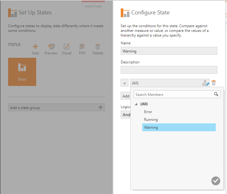

Starting from Dundas BI 5, you can do so by setting up states without using a numeric value in your definition. To do so, simply leave the measure selection on none, and define your condition on the dimension value you want to flag.
Here is a simple example of how it could look like:
Image title
Here is what the state condition definition would look like:
