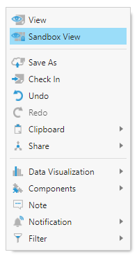

That being said, we have a variant on this tip (courtesy of ) that allows you to make edits to your dashboard, and see those changes much faster than switching back-and-forth on View Mode.
Select Sandbox View, which will open a preview of your dashboard that is sandboxed in a new window:
Image title
With this open in a separate tab, you can edit your dashboard, and to see the changes, simply refresh the sandboxed view. Once you're done looking at the changes, the edit page is right where you left it, ready to be worked on!
