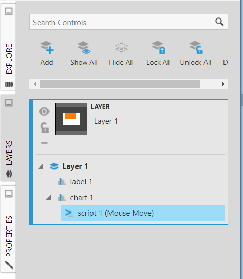

If your dashboard contains scripts, a quick way to access those would be by:
1. Opening the layers panel,
2. Expanding the layers and then the controls that the expander is showing (indicating there is a script setup for those, and
3. Finally double clicking the script, which will open the script editor directly
This way, you don't have to select the control and find the script under the different actions available
