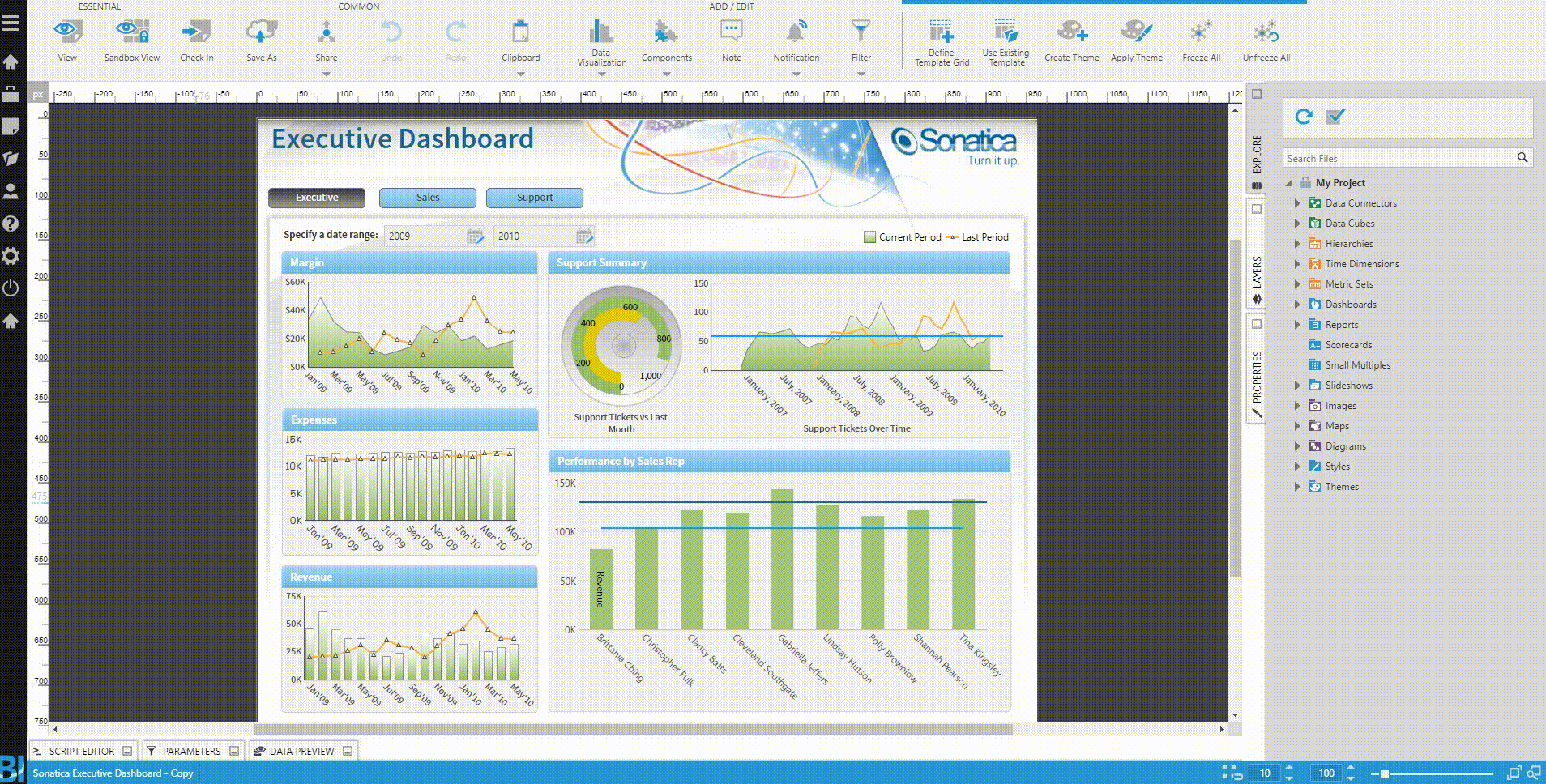

Do you want to know the dependencies option on your metric sets or dashboards to see where things come from? There are two mechanisms that can help.
FIRST:
- 1 - Right click on the dashboard and go to properties
- 2 - Click on references
- 3 - Use Show Recursive References to see the references of your references
You can see in my example that my dashboard doesn’t use any data cubes.
Click on image to enlarge
SECOND:
From the dashboard, you can go to the data analysis panel and click edit . You will then see metric set full name and analysis structure full name .
