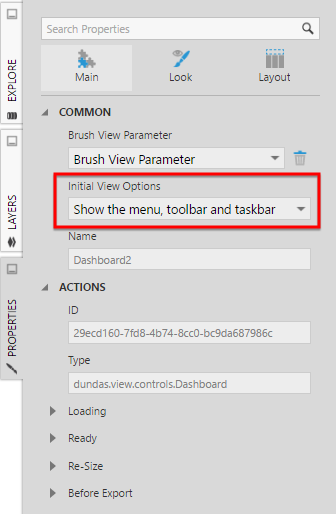

The problem is that the first link opens fine in full screen. However, every time the user clicks on a tile to open a new dashboard, it opens it in edit view. I want it to open in Full Screen just as if they were going to a short link to that dashboard.
Is this possible? If it can’t open in full screen (and I’m not sure why it would be set up like that), I would settle for a script that I could put in each dashboard’s ready event to set the page to full screen, if that is a workaround option.
