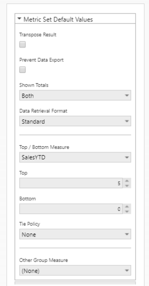

For the displaying the top/bottom records in your visualization, you can achieve this by clicking on the pencil icon beside your measure on the data analysis panel to see this feature.
em1screenshot5
Please see article below for details.
https://www.dundas.com/support/learning/documentation/analyze-data/displaying-top/bottom-records
Hope this helps.
Thanks for the reply. Here for top/bottom we are predefining to select top5 values. can we allow user to select /define the values somehow?

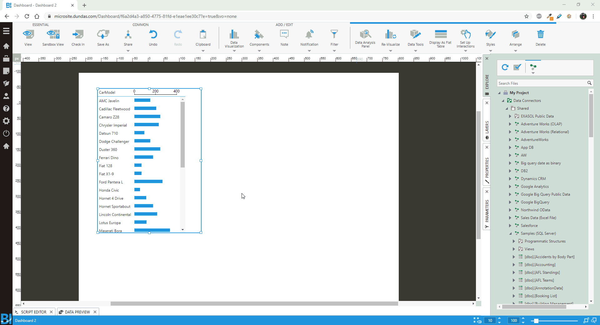

If you want to allow the user to control the TOP N values, maybe with a slider, you should use a formulas visualization to do this. Here is a quick video of me setting up so that you can follow along.
Hi Jeff!
I have done exactly what you show in the video before and it was very useful. Is it possible so that a user can access the full panel I see to set the top N values? Although that^ works most of the time, it doesn’t change the visualization itself - only the separate formula visualization you have created.
Ideally I want users of my table to be able to select:
  1. The number of rows for the top/bottom records in the table and
  2. What column out of the 4 to use as the measure
Thanks!
