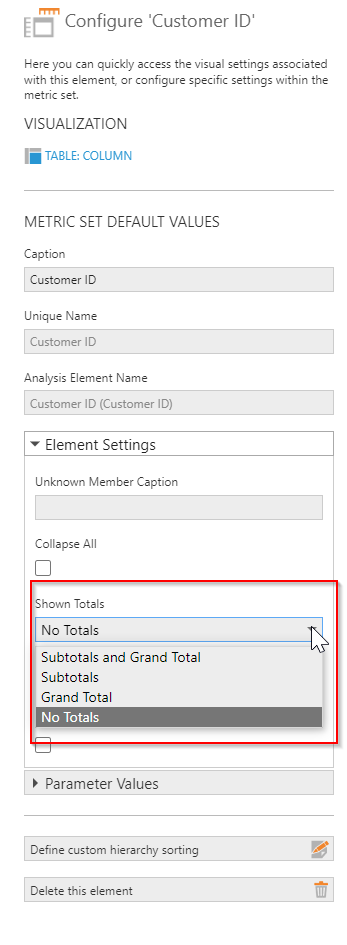

Is there a way to remove/hide column Grand Total in a table?

You can remove the grand total column by configure the “Show totals” property value into “no totals” in the row settings, please see the screenshot for your reference
Let me know if this works for you
You can set the Shown Totals setting in an individual hierarchy’s settings from the Data Analysis Panel as Denil suggested (e.g. on your time dimension hierarchy), or there is also a Shown Totals setting for the whole metric set that you can set to Rows if you only want total rows and not total columns:
