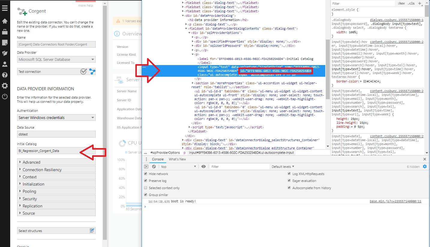

I got the following JSON while creating an Override-
dataConnectorPropertyOverrides: [{key: "4babfff6-efe6-4e17-917f-e54cfe2571a4", name: "DynamicVenue",…}]
0: {key: "4babfff6-efe6-4e17-917f-e54cfe2571a4", name: "DynamicVenue",…}
location: "/Projects Root/CEO Dashboards/DataConnectorsRootFolder"
value: [{parameterValueType: "SingleString", parameterId: "8ffe4086-6013-4586-902c-fda2502548d4",…}]
0: {parameterValueType: "SingleString", parameterId: "8ffe4086-6013-4586-902c-fda2502548d4",…}
__classType: “dundas.account.ProviderPropertyOverride”
location: “/Projects Root/CEO Dashboards/DataConnectorsRootFolder”
value: [{parameterValueType: “SingleString”, parameterId: “8ffe4086-6013-4586-902c-fda2502548d4”,…}]
Where I need to add the name of new “Initial Catalogue” for which I am overriding?
Thanks
Created a new sample below for using TenantData, the one for initial catalog is 8ffe4086-6013-4586-902c-fda2502548d4:

Do we need to pass more parameters that includes the server credentials and other?
You only need to pass the parameters that you want to override, if you do not want to override the server credentials I would not include them.
Also what would be the best approach to find the InitialCatalouge ID through the API '?
Unfortunately there is not an easy way to do this as they are part of the extension and are not documented in the API docs. I’ve put a request in to have them documented but as of now they are not. Below is a picture of how you can get the ID for the initial catalog property for the SQL Server database using developer tools.

To query for the dataconnectors to get the ID’s for them you will need to query the file system, you have already created dataconnectors?
https://www.dundas.com/support/api-docs/rest/#Dundas%20BI%20REST%20API%20Reference/File/Query/POST.html
I’ve added a small sample below that queries the dataconnector folder mine has an ID of ‘dbc93987-6486-425f-869c-fa9e39f7a091’ returns the an array of FileData:

Created a simple table of data provider property ID’s for reference:
There is a feature request ticket that will allow them to be easily extracted directly from the UI.

With that, It will be possible for me to access the Initial Catalogue ID/ Database ID/ Parameter ID by Data base name ??
I think you need to do is
  1. create one dataconnector which connects to a database (this would be one of the “there are more than 100 Databases”) .
  2. Then override that data connector when creating a tenant. You would use the data connector ID you would override the initial catalog by using the property on the SQL server dataconnector which is defined as “8FFE4086-6013-4586-902C-FDA2502548D4” as defined in the table above. You would use the dataconnector ID. You would never use a database ID.
Note the schema needs to be the same when using dataconnector overrides.
