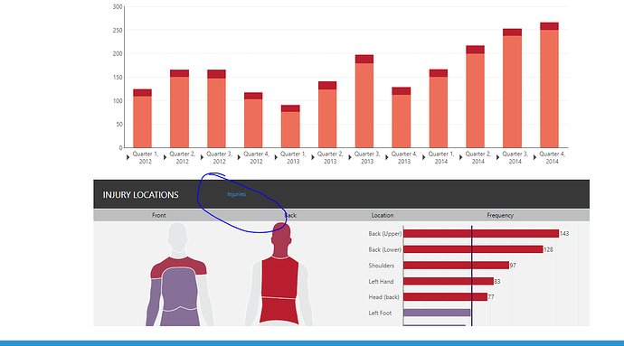

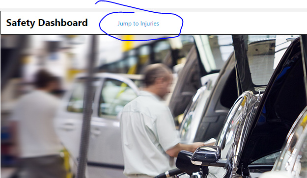

You can do this with HTML labels. At the top of the screen, add a HTML label that the user can click on to navigate.
Add the following HTML to it:
<a href="#C4">Jump to Injuries</a>
Where you want the jump target to appear, add another HTML label. If you’re using frames like I am, you might considering replacing the frame label text with your new HTML label so that your user is jumping to the title.
Add this script to the label :
<a name="C4">Injuries</a>
That’s it, you can now click on the navigation section and be jumped to the section you want.
