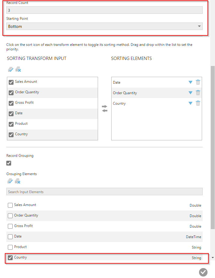

One method you could try is to use a cube and transform the cube using Top/Bottom transform with grouping enabled. You can configure it as shown below:
