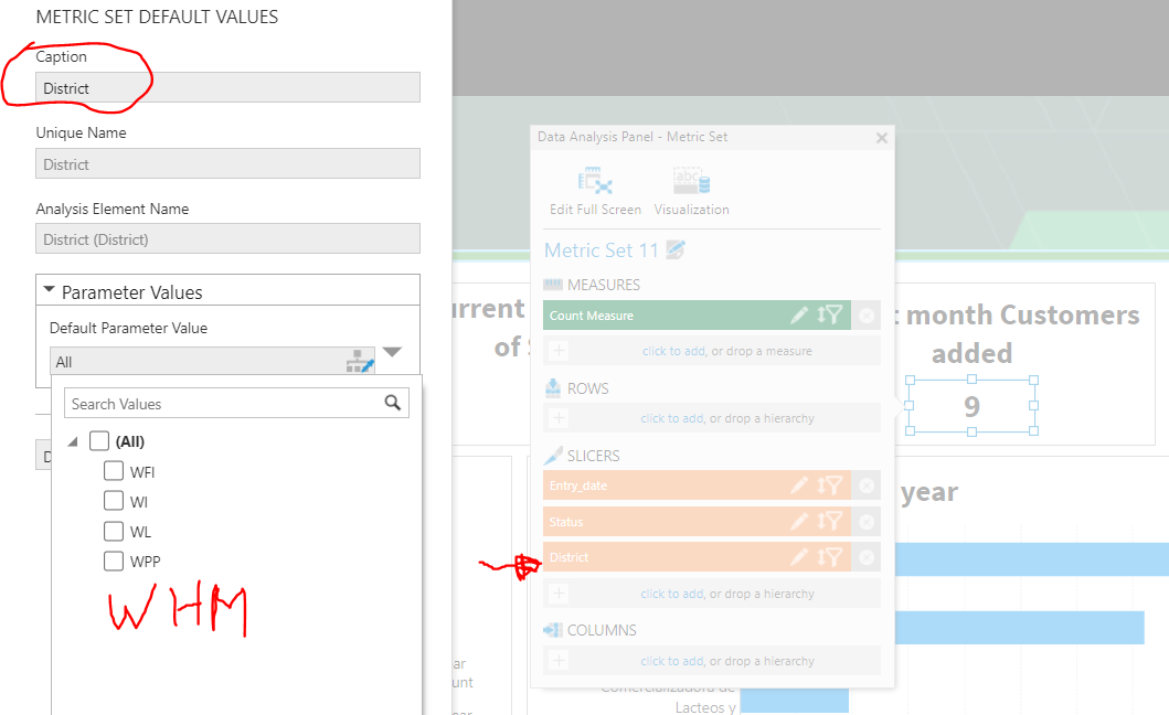

How to setup a parameter when the value doesn’t exit in this month?.
According my example, in this month doesn’t exist the District “WHM” but maybe in the next month could be exist. I would like to setup as a default “WHM” in the District field.

The members displayed are the members currently available in the database for that particular column. If new members could come in the future that you’d want to include then you need to use the ‘All’ token, or if it’s a range the ‘Open Boundary Token’ to include as-of-yet un-added members.
There’s no way to select members that don’t exist yet since they do not exist.
