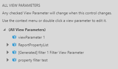

For the specific dashboard I am working with, there is no “Brush View Parameter” listed under the parameters. Have you encountered that error before? I went to a clean dashboard and I can see that the Brush View Parameter was automatically generated, but it does not appear on my dashboard. I uploaded a photo of my view here.

Hi Kali,
Every dashboard starts out with one, but there is nothing special about it other than being set as the Brush View Parameter in the dashboard’s properties, and you’re allowed to delete it. You can create a new view parameter and select it as the new brush view parameter in the dashboard’s properties for it to work the same way.
