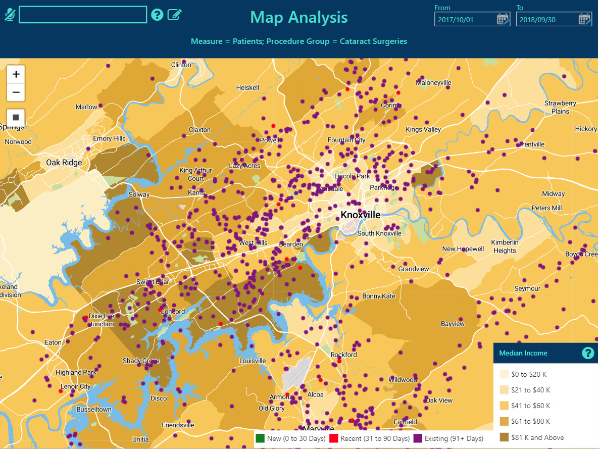

Hi Brandon,
Jeff’s option is # 1. But if you’re trying to plot a lot of data, you may run into performance problems. If this happens to you, let us know and I’ll give you an alternative. In the map below, I’ve mapped out U.S. census tracts and then plotted patients on top of them. You can do this with Jeff’s solution, too. The difference is that I can plot 20,000 points in a few seconds, whereas I find the limit considerably less with the shapefile maps and built-in mechanisms.
