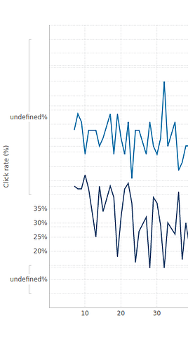

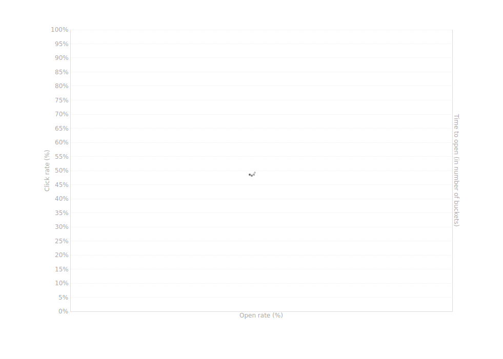

For instance, while the dashboard is loading I see this (left axis is of interest here):
But once the data is in, I see:
where there are only legend points from 20 to 35, whereas I would still want to see 0% to 100%.

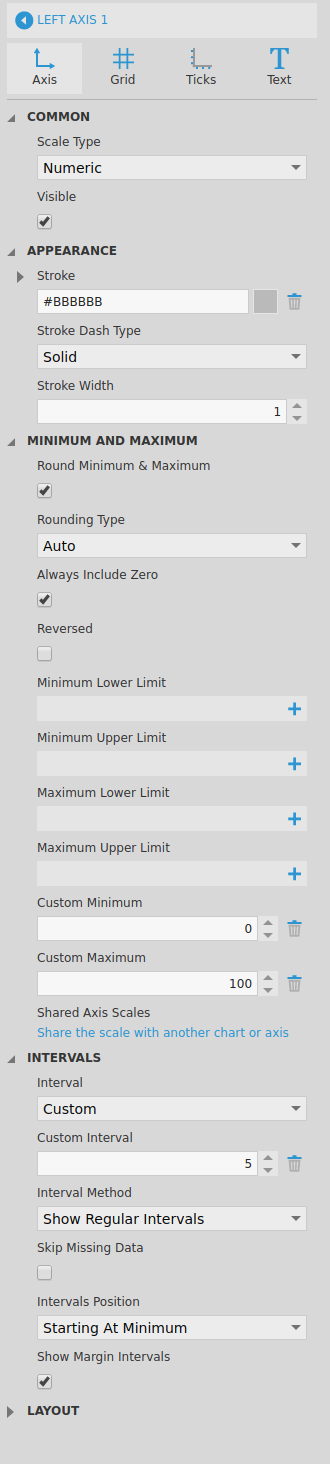

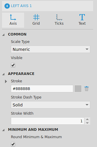

This is how I configured my axis:
With my custom minimum, custom maximum, custom offset and ‘show margin interval’, I expected to nicely see from 0 to 100 in the left axis.
Is there a way to achieve what I want to do?
On a side note, when looking at intervals for an axis, I can set them up in the ‘axis’, ‘grid’ or ‘text’ tab. I have no idea which one wins and I find it quite confusing
