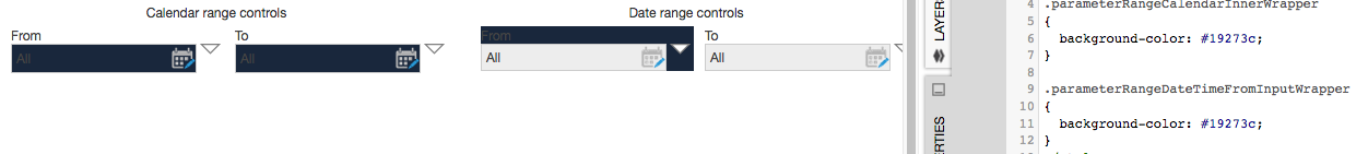

That is close, but the wrong control. I used the wrong object name in my original post. I am needing it for the Date range control. Here is a screen shot of the issue that I am having.
Range Date uses an <input>, so you will have to target it a bit differently. Something like:
.parameterRangeDateTimeWrapper .parameterControl-fieldsetInput input {
Thanks Elia, it was the last 'input' in the string that I was missing. Working fine now.
