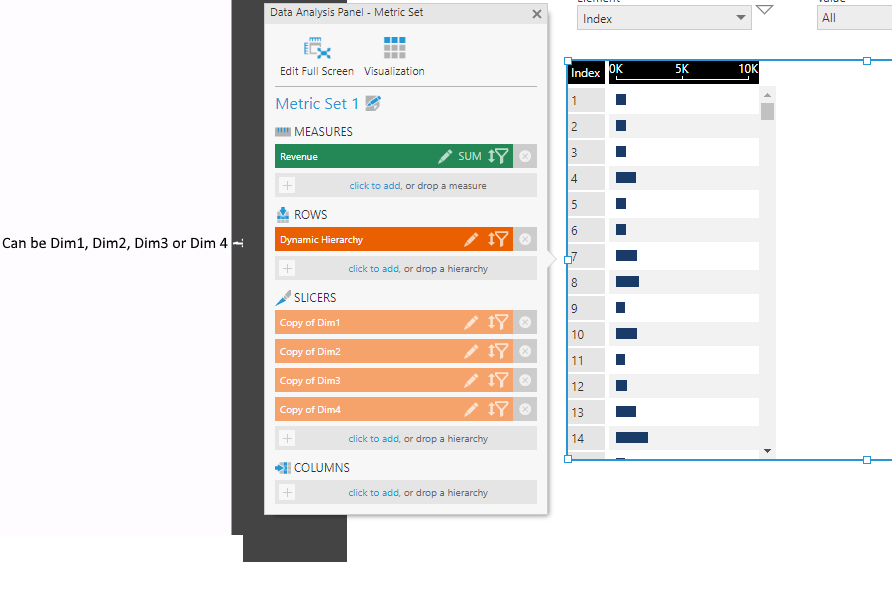

Example:
From the example above, we have added slicers for our possible dimensions so that we can add 4 filters to the dashboard. The problem with this idea is that the Dynamic Hierarchy can be Dim1…4 and it’s not possible to use the same Field from a database in both the Rows (Dynamic Hierarchy) and the Slicer at the same time. If you do duplicate the field using a Dynamic Hierarchy, you’re going to get an error message.

This way, you can use the original 4 Dim’s in your dynamic hierarchy and the copies for filtering. Like this:
