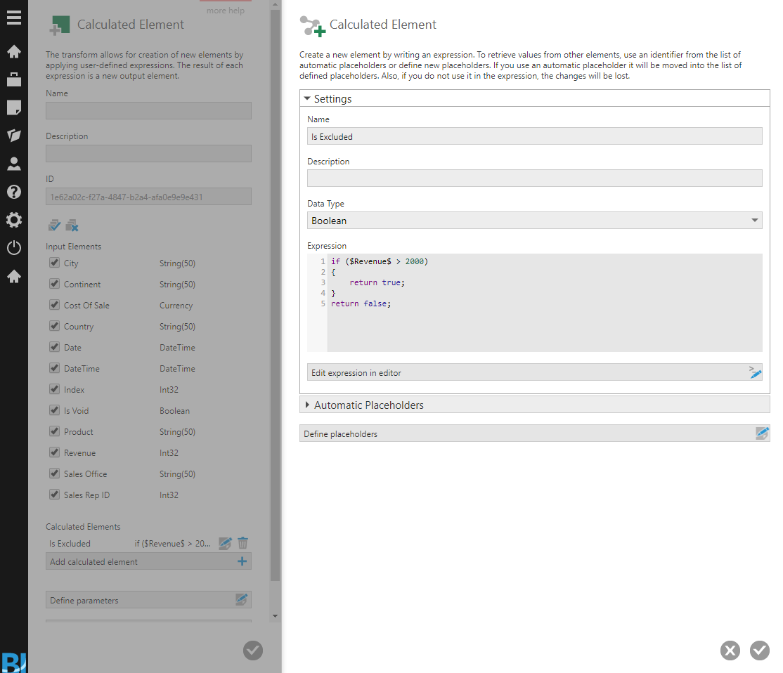

From my understanding, you are running into an issue of pre-aggregation vs post-aggregation where your filtering needs to happen before any aggregation on the metric set.
One approach is to create a data cube and use the calculated element to perform a check - pre-aggregation. The code below will create a new “Is Excluded” field in the data that you can have your users filter on with a simple checkbox.

You can still use my approach of doing this work in the Data Cube and still give the user control over the values that you’re filtering against. Did you know that you can build filters directly into the Data Cube which will be applied before any aggregation you do in the Metric Set?
Below is an example where i create a public parameter that you can use to give the user control. Note: Checking it off as public allows you to hook into this parameter on the dashboard.
