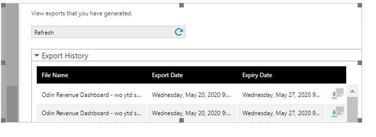

I want a script to export PDF and PPT on a button click.
I tried scripts available on website:
https://www.dundas.com/support/developer/script-library/export/page-2
The PDF script did not work and ppt script work but the output was generated in export window. How can I directly download the exports ?
You need to grab the object returned from the export and force the browser to download it.
Have a look at the code from line 95 to the end of this example https://www.dundas.com/support/developer/script-library/export/create-a-pdf-export
If that’s not working for you - check your browser settings, it could be blocking popup or file downloads from the site
