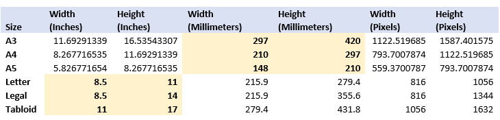

This might help you too.
We include a few of the A series paper sizes from ISO 216 as well as US paper sizes as selectable standard paper sizes. Regardless of what unit the paper size is defined in, we use a 0.5” margin (i.e. A series sizes will get 12.7mm margins). Their exact definition is in bold and highlighted in yellow. Custom can always be specified as well.
The total interior space available is always going to be the oriented paper size (i.e. switch width/height if you use Landscape), and the subtract the left/right margin values from that oriented width, and top/bottom margin from oriented height. He can take advantage of our code we have to get some of this easily. For example:
