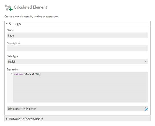

1) create a data cube with your data source
2) Add a calculated element transform that assigns a page number to each row. The expression below will return 10 rows at a time.
