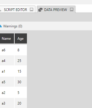

In order to display the count for a continuous variable you can create formula measure. For example, I have a cube with age and name as shown below:

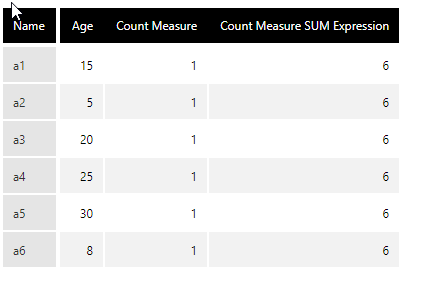

Now at the dashboard level, I have created a formula measure that will display the SUM of count measure, as shown below:
