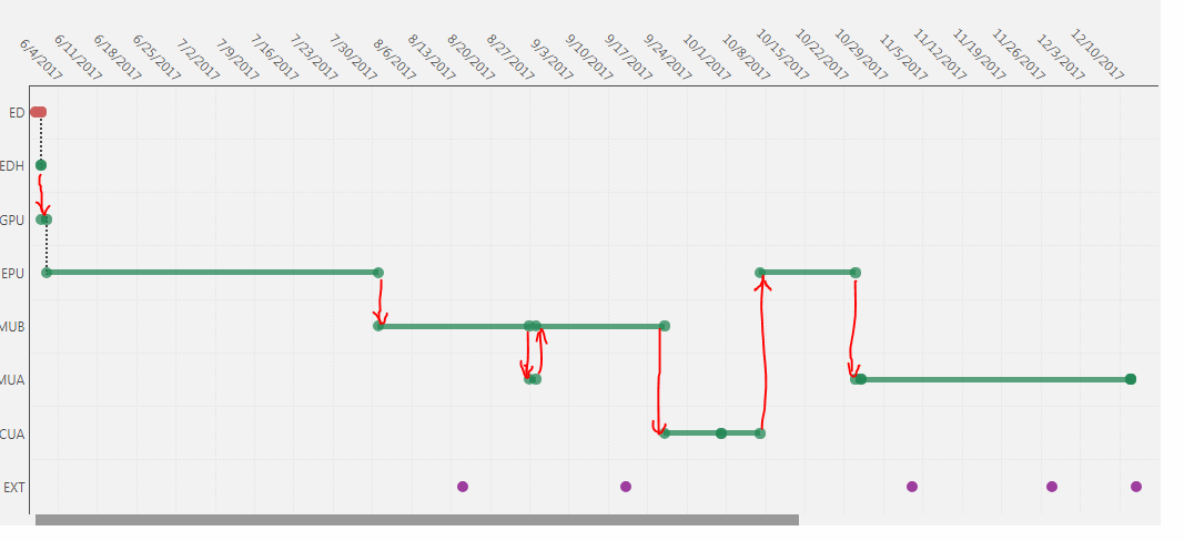

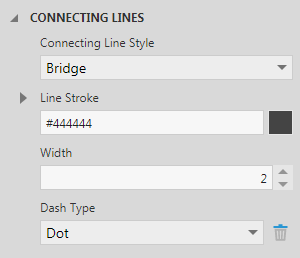

I'm trying to chart the movement of a client through our hospital, and the "connecting lines" feature really helps to visualize their path. I currently have it set up to display a "bridge" style connecting line between range bars. They are all within the same series on the chart. The end date of each bar is the exact start date of the next bar. I couldn't find any documentation on how Dundas actually determines how these lines are drawn, and there are very limited settings avilable in the properties pane. The issue is that the lines are drawn inconsistently. As you can see in the image below, sometimes it works perfectly and sometimes it just doesn't draw a line at all. In some cases the lines will appear when the chart is zoomed in along the x-axis, in some cases it won't. That's why the red guy has a frustrated face. Does anyone have any idea what is causing this inconsistency and how to fix it?

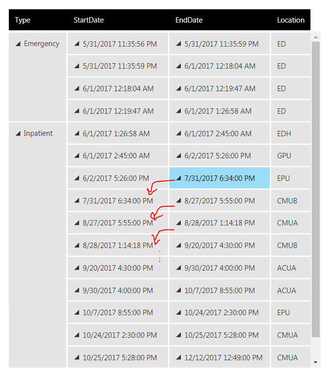

There is no mismatch - the start and end dates of adjacent points are exactly the same, I can verify this by revisualizing as a table:

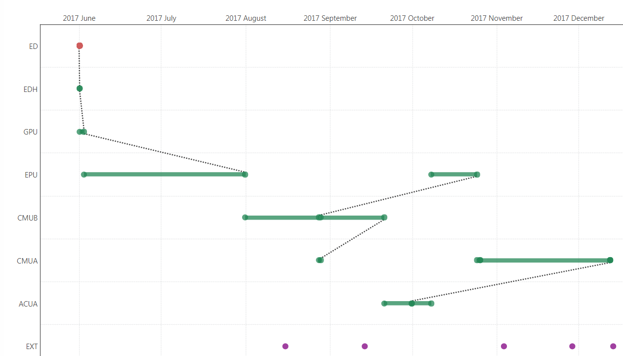

I tried the Between option, it seems to draw a line between the extremes of rows (the locations on the left axis) with no discernible pattern for a given connection:

Your table dates don't match the dates in your original post where the lines didn't connect. Could you try to identify the exact location where the lines do not connect?
Sorry, I was using a different example, but the issue occurs on all of them. What I would like to figure out is WHY bridge lines are drawn in some cases but not others.
Using my 2nd example above, notice that Dundas successfully draws 2 bridge lines and misses all the rest. Why these 2 and not the others? All the dates "line up" perfectly - there is no overlap. I even tried using different levels of a date hierarchy to see if that would help (e.g. ignoring time granularity and setting the data points to the 'day' level) but it had no effect. The red lines indicate what I am trying to achieve, and what I would expect this "bridge" functionality to do:

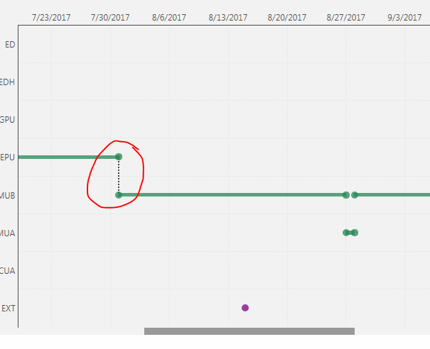

Zooming in on the first section (June 1, 2017), I can see that one of the lines appears and one does not (just like in the original zoomed-out screenshot):
Zooming in on another section (Jul 31, 2017) I can see the connecting line magically appears (where it did not appear in the original zoomed-out screenshot). But the line that should appear for Aug 27 still doesn't show up. However, what I noticed is that as Dundas animates the zoom-in, the missing line at Aug 27 appears momentarily before vanishing. Any further zooming has no effect.
