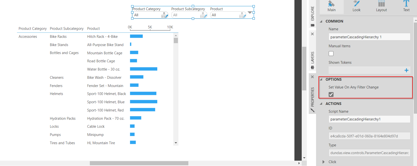

If you would like the child node to get automatically set to the selection made in the parent hierarchies, please enable the option ‘Set Value on Any Filter Change’ option in the properties panel of the cascading filter. This way even if the middle hierarchy is ‘none’, the child node will show all the values in the category selected in the parent node. Please see below screenshots:
