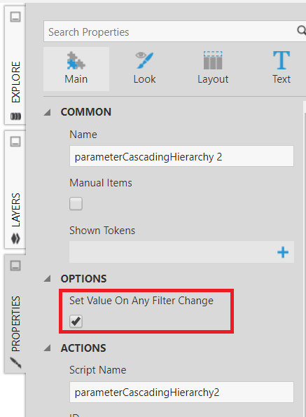

Hi Guillaume,
You can select a level by enabling the ‘Set Value On Any Filter Change’ from the properties panel of cascading Hierarchy.
Please, keep me updated and let me know if you have any other questions.
Regards,
Hi Armin,
Thanks for your answer. I already found that out and wrote an answer, but actually forgot to post it.
I did try before it but as it duplicates the value of the last level selected into the lower level, it is not was I expected and thought it was wrong. Well it was not, and I’m glad it works,
