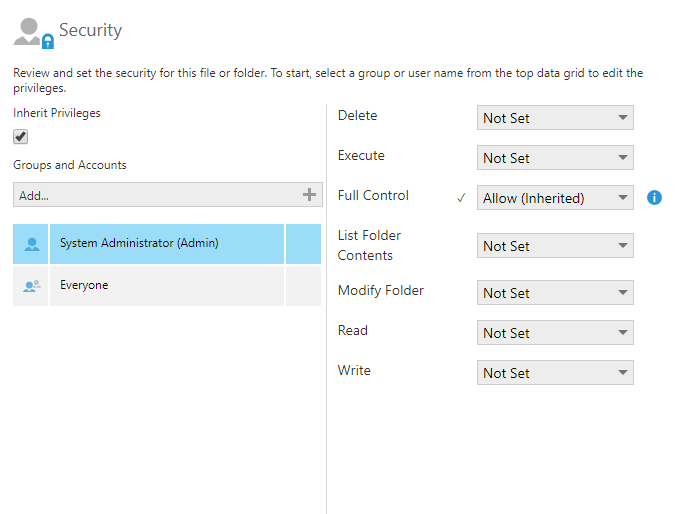

Hello @ravi.bansal,
If I understand correctly. I think your account have to be added here (on project security or dashboard security) :

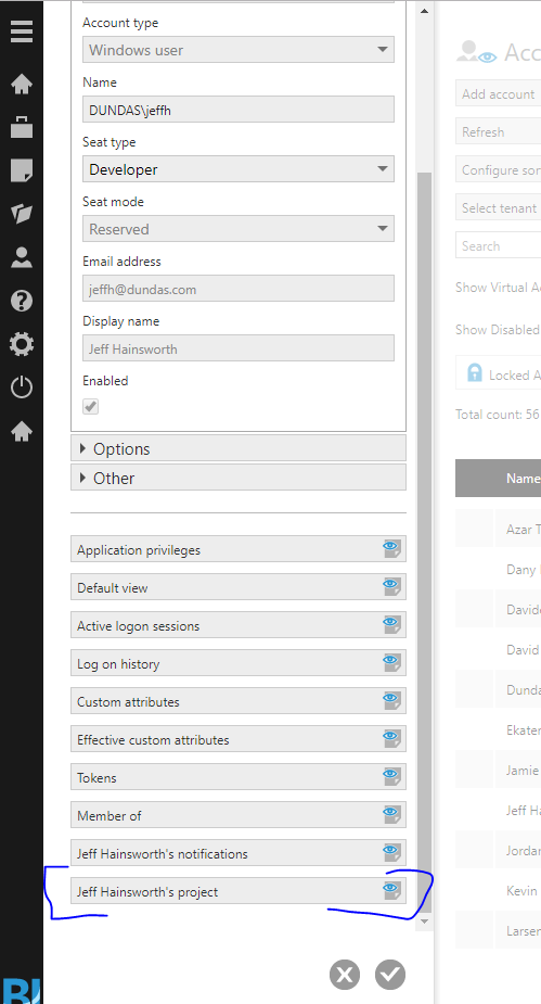

@ravi.bansal - if you’re having trouble physically locating someone else’s ‘my project’, it’s because other people’s projects are not listed in the projects list. To see someone else’s project, go into the admin screen and you’ll see the option under the account.
It’s also possible to set this project via script if you want to go that direction and i can help if you need it.
