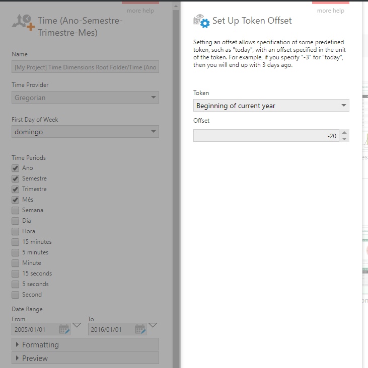

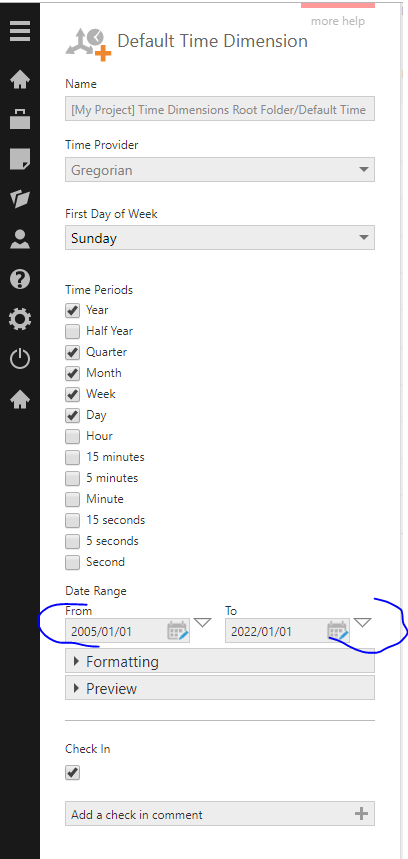

Hi Jen,
What are you filtering, is it a time dimension or a date? If it’s a time dimension you can configure what range appears in the filter by changing the time dimension. Editing the corresponding time dimension you can set the date range, changing the “from” to be the current year and an offset of -20 for the “to” you can set the current year, see image below.

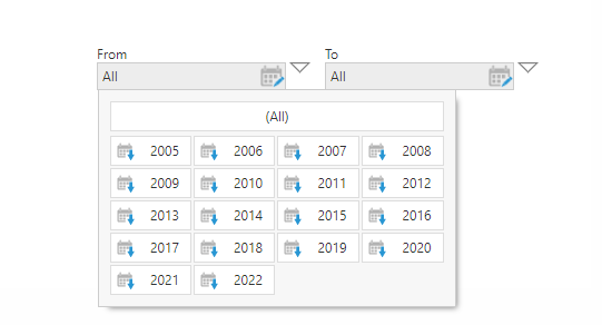

Hi Jennifer,
If you use a time hierarchy and define a range, the Calendar Range picker will automatically show only the range of the time hierarchy.
Here is a parameter using this hierarchy.
I believe this will give you what you are looking for.

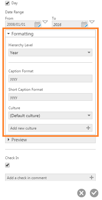

You can format what appears inside by changing the formatting settings of the time dimension.
https://www.dundas.com/Support/learning/documentation/analyze-data/create-a-time-dimension
After formatting it, you can see how it will look like inside the preview tab.
