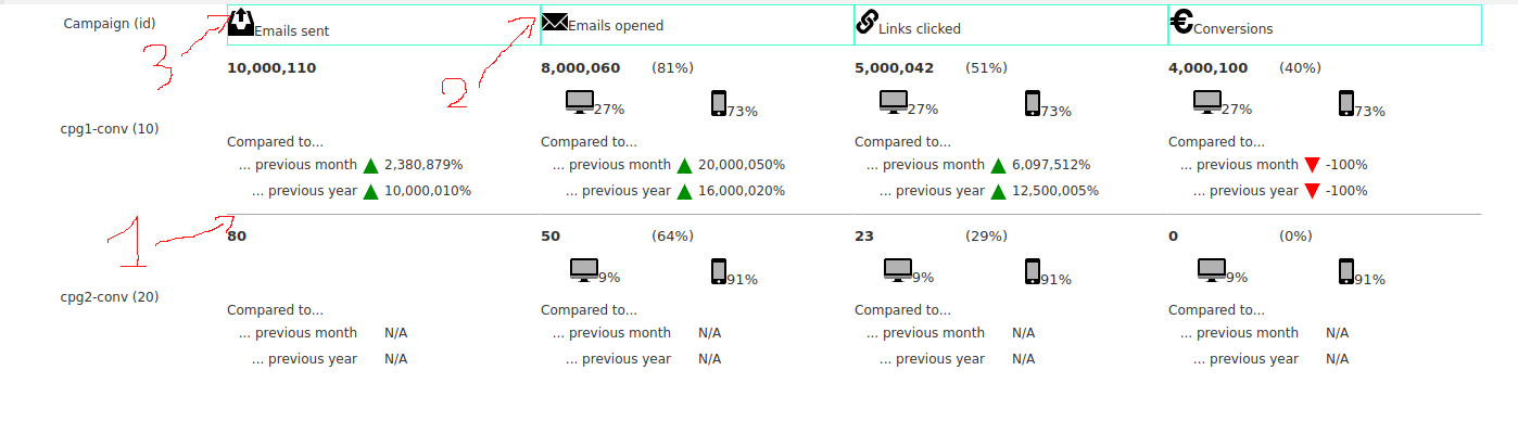

I have a small multiple which I am trying to style, Specifically, I am trying to have a grey bar separating each row including row headers, and have a kind of border around the header row (but not between header cells).
In this beautiful small multiple:
    1. and 3) should go up to the left
    1. should not exist.
Those borders are actually 2 different types of borders:
  • the grey one (2) is a row separator line for the small multiple main cell. How can I have it extend to the header row? Or how can I set the same to the header row?
  • the green one (1 and 3) is actually the border of the one label taking 100% of the area of the column header cell. I could do the same to the leftmost label in the header, but the issue of left and right borders still remains. Is there a way to disable right and left borders?

There isn’t a row (or column) separator line property yet for any headers in small multiples or reports, so I added you to a feature request for this.
If you’re using a label to display some of those borders, you can expand the Border property and set Left and Right to 0, which I think should work to display only horizontal lines. You can do this with the label in the corner as well.
The label in the row header could be given a border only along the bottom, but to make this match up with the main cells I think you’ll need to position the row separator in a similar way there yourself rather than use the Row Separator Lines property.
Hope that works for you.
Jamie
Hi Jamie,
Expanding the border property is actually possible for html labels, but not for data labels. I didn’t notice it at first (and I think it would be nice to have it available for all types of labels) but now that I know, the workaround is easy: I just add an empty html label, using 100% of the area, with a low z-index.
Thanks!
Great - data labels will have the same border options in version 7 for wherever you use those, but for now yes, you could place a regular Label, HTML Label.
