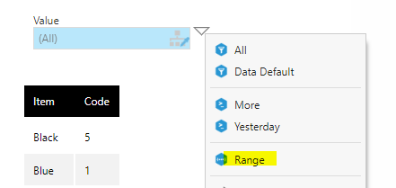

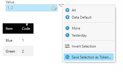

You can achieve this by using custom tokens and saving the ids as name set token such that the user can reuse this selection as desired.
emscreenshot1
emscreenshot2
emscreenshot3

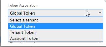

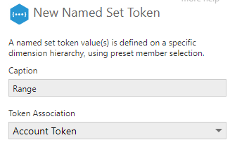

Additionally you configure the token such that it is only available to this user by selecting the account token from the token association drop down list when creating the token.
emscreenshot4
