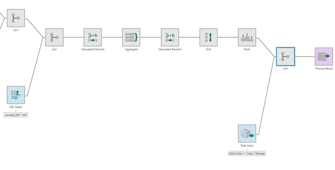

So this is my cube:
What I want to achieve is almost the exact same thing as in the video, but the problem is that my data is dynamic (rows can be added).
In my cube I have 'n' colomns (no primary key) and in the data input cube I have a 'status' column. (no PK).
In order to join my cube and the data input cube, I need to have a primary key, which I am trying to generate (and don't know how) and add in my cube. After I learn how to generate it, I will copy it into the input cube, and then I will be able to do the join.

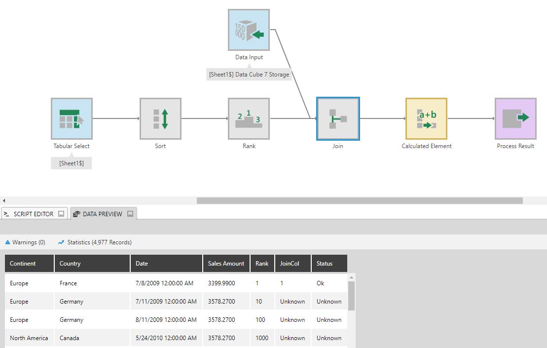

You can probably achieve a solution with the design that you have in mind using the following approach:
  • Create PK column on your cube flow that represent your source data (not the data input cube). If you expect to be able to always sort the source data in a way that will return new inserted rows at the bottom than you can use the Dundas BI built in Rank transform. If the sort order is expected to change then you can use the Python transform to create the logic that you need to ensure that new values are inserted only to new rows in the K column.
  • Your data input flow of the cube will have 2 columns: JoinCol (that is the column you will use for the join with the PK column in the source flow) and the status column. Both empty by default.
  • Use a left join to join the 2 flows. You can then have a calculated column to return a certain status value if the status value is Unknown (meaning it was never set by the users on the dashboard).
  • Then on the dashboard, when the users set the status value they want (right it back to the data input) you would write back the status value they choose as well as the PK value from the source flow into the JoinCol of the data input.
Thanks for the formula Ariel. I tried to play with the Rank option but I noticed it doesn't work with the join (the join doesn't show any results after I apply all the above). Tried to join with another column and it worked so I guess the Rank is the problem...
Can you please confirm the join doesn't show any results using a left join? If so, I suggest you move this matter over to the Dundas Support team.
Hi Ariel,
It managed to work but only when I copied the rank column with a calculated element and transformed it into string. Also the column in the Data Input cube must be string format.
With double format, it didn’t work.
